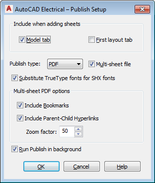

  5. On the AutoCAD Electrical Publish Setup dialog box, select PDF as the publish type.
  6. Check Multi-sheet file.
  7. Check whether to substitute TrueType fonts for SHX fonts.
    • A text object using a Truetype text font is searchable within a PDF file.
    • A text object using an SHX font is drawn as graphics in the PDF file. The text value is added as a comment in the PDF file and can be found by searching in the comments.
  8. Check Include Bookmarks to include the project structure as bookmarks in the PDF file.
  9. Check Include Parent-Child Hyperlinks.
  10. Define the zoom factor which controls how close the PDF file is zoomed in on the object you jump to. Enter a value from 1 through 100.
  11. Click OK.
    The Publish dialog box opens with PDF and multi-sheet preselected.
  12. If you included bookmarks on the AutoCAD Electrical Publish Setup dialog box, click Publish Options and clear Create bookmarks.
    Note: If both the AutoCAD Electrical and AutoCAD bookmarks are selected, the PDF file includes both the project structure bookmarks and the sheet list bookmarks.
  13. Adjust other options as necessary.
  14. Click Publish.
