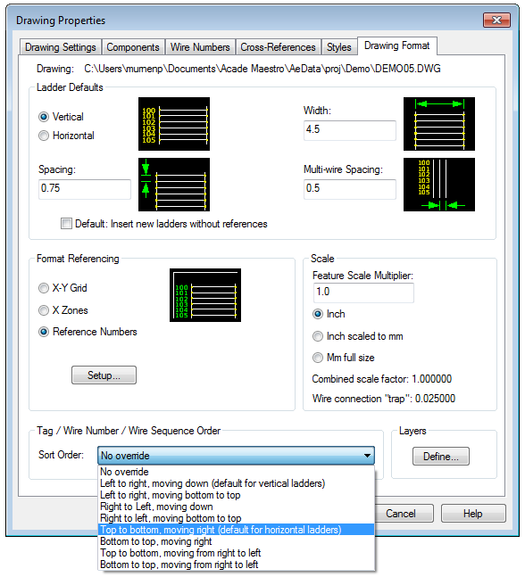

  4. Use the Sort order drawing property to determine the connections for anything not accounted for in the previous checks.
