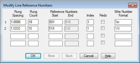

  1. Click Schematic tabEdit Wires/Wire Numbers panelModify Ladder drop-downRevise Ladder. Find
    The Modify Line Reference Numbers dialog box displays a list of ladders in the drawing.
  2. Change the beginning line reference numbers for each ladder. Change the first ladder to 101 (column 1, line 01) and the second ladder to 201 (column 2, line 01).
  3. Click OK.
    The reference numbers update along each ladder.
