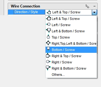

Expand the Wire Connection section of the Symbol Builder Attribute Editor.
Expand the Direction/Style list and select Others to launch the Insert Wire Connections dialog box.
On the Insert Wire Connections dialog box, select Terminal Style: Screw.
Select Connection Direction: Left.
Check Use this configuration as default. This directs Symbol Builder to use the current Terminal Style and Scale as the default in the drop-down list.
(Optional) Enter “L1” as the TERM01 value. This sets “L1” as the default terminal pin number when the symbol is used.
(Optional) Select X4TERMDESC01 in the Pin Information section and click Delete. This directs Symbol Builder not to insert the optional attribute with the wire connection attribute.
Click Insert and select in the center of the left-hand side of the rectangle as shown. The wire connection attribute, X4TERM01, and the terminal pin attribute, TERM01, are inserted.
Back on the Symbol Builder Attribute Editor, expand the Wire Connection list and select Bottom/Screw.
Select the Insert Wire Connection tool and insert the terminal in the bottom center of the rectangle.
Select Right/Screw from the Wire Connection Direction/Style list.
Select the Insert Wire Connection tool and insert the terminal in the center of the right-hand side of the rectangle.

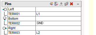

In the Pins section, enter “GND” in the TERM02 value, and “L2” in the TERM03 value.
