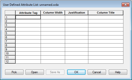

Use the User Attributes tool to add custom fields to your reports.
. Find
For example, the Mount value on a panel footprint can be in xdata VIA_WD_MOUNT or on a MOUNT attribute. To include the Mount value in a panel report, enter MOUNT as the field name.
Right-click in a cell to copy, cut, or paste contents from one cell into another.
The first time the grid content is saved, the Save As dialog box displays. Enter the file name and click Save.
