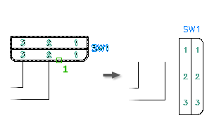

Rotate connector using the V key
Press "V" at the command prompt to switch between vertical and horizontal orientations. Based on where the outline is in the flip process, the Tab keystroke reverses the connector either about its long axis or end for end. When in its horizontal orientation, a series of Tabs cycles the image through these four orientations

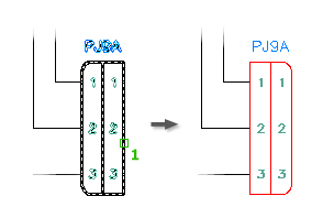

The parametrically generated connector is a block with attributes. Tools are provided for modifying the connector block after insertion.
Rotates a connector image in 90 degree increments.
Existing wire connections do not reroute with each rotation of the connector. Use the wire editing tools to resolve wiring.
Reverses the connector image about its long axis.
Existing wire connections do not automatically reroute to the reverse side of the connector. Use the wire editing tools to resolve wiring.

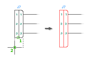

You can increase or decrease the overall shell length of the connector. Identify which end of the connector to alter and the measurement of displacement.

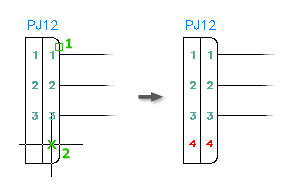

Adds connector pins to an existing connector.
To make room for the new pins:

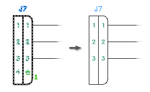

Deletes connector pins from an existing connector.
If the connector has a defined pin list, free this deleted pin for later insertion on this connector or on a related child of this connector.

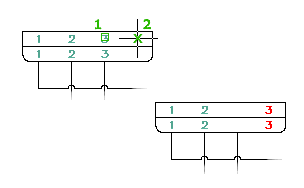

Moves the connector pin associated to a selected connector.
The pin relocates along the centerline axis of the connector, even if the pick point is off to one side of the connector. You can specify a location beyond either end of the current connector shell. Use Stretch Connector to extend the shell to enclose these pins.
