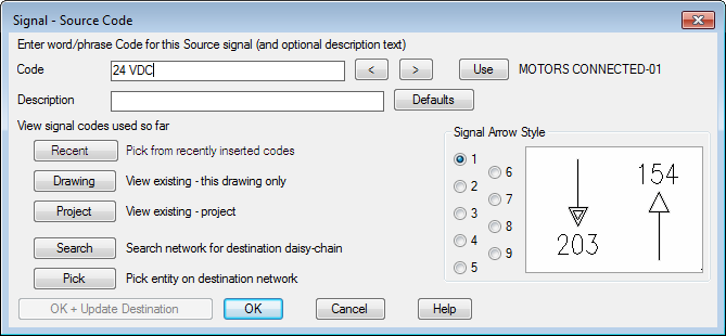

  4. In the Signal - Source Code dialog box, specify:
    Code:  24 VDC
    Signal Arrow Style:  1
    AutoCAD Electrical allows one description line on a source arrow. This description can then be carried over to the associated destination arrow. You can define some default description lines to make them easier to enter without typing them in each time. AutoCAD Electrical looks for a file called WDSRCDST.WDD. This file is a simple text file with each line being read as a separate description. If this file exists, the Defaults button is available on the Signal - Source Code and Insert Destination Code dialog boxes.
  5. Click OK.
