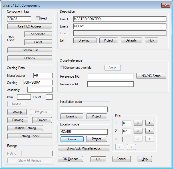

  9. In the Insert/Edit Component dialog box, verify that the Component Tag is set to CR403.
    AutoCAD Electrical automatically determines the unique tag name for the new relay based on the line reference location that you inserted the symbol on. “CR” indicates that it is a control relay and “403” indicates that the symbol is on line reference 403. If you inserted this symbol on line reference 404 then the tag name would be “CR404.”

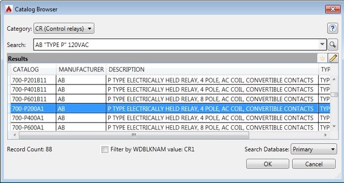

  10. In the Catalog Data section, click Lookup.
  11. On the Catalog Browser dialog box, enter AB "TYPE P" 120VAC as the search string.
  12. Click .
  13. Select 700-P200A1.
  14. In the Catalog Browser dialog box, click OK.
    The selected manufacturer code and catalog number display in the Insert/Edit Component dialog box. When you click OK on the dialog box, the values transfers to the symbol.

  15. In the Insert/Edit Component dialog box, Description section, specify:
    Line 1:  MASTER CONTROL
    Line 2:  RELAY
    Up to three lines of description text can be entered as a description for components. If the third description line is unavailable, the symbol does not carry an attribute for a third line of description.
    Note: You can specify a description by entering text or by clicking Defaults to select from a list of standard component descriptions.
  16. In the Insert/Edit Component dialog box, Location code section, click Drawing.
    AutoCAD Electrical does a quick read of the drawing file and returns a list of all location codes used so far.
  17. In the All Locations - Drawing dialog box, select MCAB5 and click OK.

  18. In the Insert/Edit Component dialog box, the pin values are inserted based on the selected catalog number:
    Pins: 1:  K1
    Pins: 2:  K2
  19. In the Insert/Edit Component dialog box, click OK.
    Any values entered here are saved as attribute values on the symbol itself.
