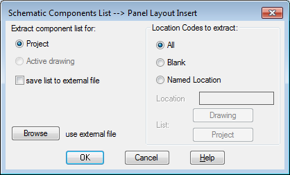

  4. Click Panel tabInsert Component Footprints panelInsert Footprints drop-downSchematic List. Find
  5. In the Schematic Component List -- Panel Layout Insert dialog box, verify:
    Extract component list for:  Project
    Location Codes to extract:  All
  6. Click OK.

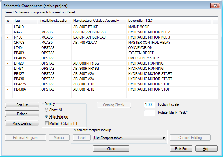

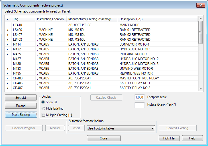

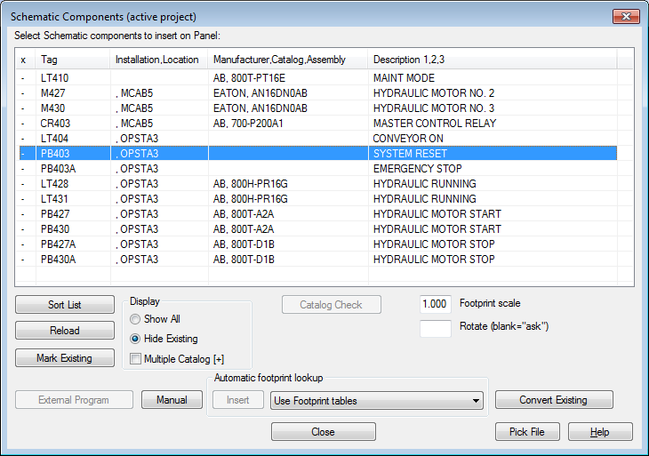

  9. In the Schematic Components (active project) dialog box, click Mark Existing. An x marks the footprints that are already placed in the project.
    You cannot insert the same component multiple times. If you select an item with an x, the Insert button is disabled.
    Note: An o next to a component in the list indicates that a panel component with a matching component tag was found, but the catalog information does not match.
  10. In the Schematic Components (active project) dialog box, Display section, select Hide Existing.
    The schematic component footprints not yet inserted into the panel layout are displayed.

  1. In the Schematics Components (active project) dialog box, select PB403 OPSTA3 SYSTEM RESET.
  2. Click Manual.
    Note: The Manual button is used when schematic component footprints do not have a manufacturer and catalog number defined.

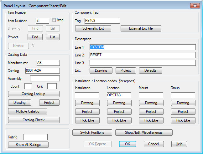

    The component may already have an Item Number assigned. If AutoCAD Electrical finds a component with the same catalog information, it automatically assigns the same item number to this new component. If no item number is assigned, and you think a matching component exists, use one of the Find buttons to look through the drawing or project. If no matching component is found, click Next to assign an item number to this footprint. This button updates each time you insert a footprint and assign an item number. This item or detail number is used for BOM and component reporting and can be referenced by optional balloon labels tied to the footprint. If you do not want the item number to change if Resequence Item Numbers is run later on, check fixed next to the item number.
    Note: The Panel Layout - Component Insert/Edit dialog box displays each time you insert a panel footprint. Information from the schematic representation is automatically carried over to the panel footprint representation.
  9. In the Panel Layout - Component Insert/Edit dialog box, click OK.
    The Schematics Component (active project) dialog box redisplays. You can continue inserting components from the schematic list of the project.

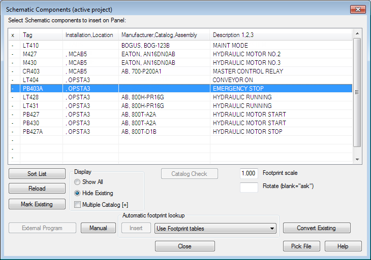

  1. In the Schematic Components (active project) dialog box, select: PB403A OPSTA3 EMERGENCY STOP.
  2. Click Manual.

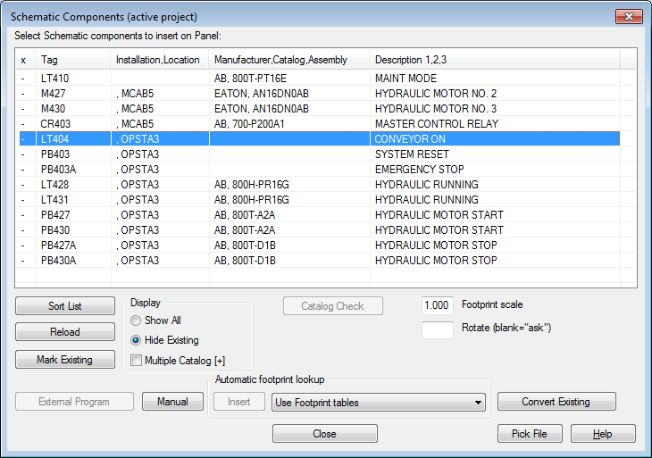

  1. In the Schematic Components (active project) dialog box, select LT404 OPTSTA3 CONVEYOR ON.
  2. Click Manual.

    In the Schematics Components (active project) dialog box, notice the master control relay must still be placed.
  10. In the Schematic Components (active project) dialog box, click Close.
