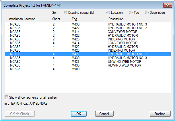

Linking the parent coil to the child contactor
The Insert/Edit Child Component displays.
The tag M427 is now displayed in the Component Tag edit box. Notice that the description, cross-reference, and location code boxes have also updated.
The components are now linked. If you go back to drawing AEGS04.dwg and look at the motor starter coil, it shows references to these three child contacts (plus one seal contact around PB427).

Notice that the fuse, disconnect, and motor automatically retag based on their reference locations.
The tag M430 is now displayed in the Component Tag edit box. Notice that the description, cross-reference, and location code boxes have also updated.
