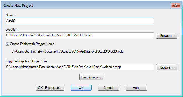

  3. In the Create New Project dialog box, specify:
    A name must be entered to define any of the project properties. The .wdp extension is not required in the edit box.
  4. Make sure wddemo.wdp is specified in the Copy Settings from Project File edit box.
  5. Click OK-Properties.
Your new project is added to the current projects list and automatically becomes the active project.
The Project Properties dialog box displays, where you can modify your project default settings. All information defined on these tabs are saved to the project definition file as project defaults and settings.

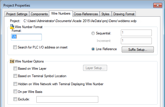

  3. Click the Wire Numbers tab.
  4. In the Wire Number Format section, verify that Line Reference is selected.
    This selection creates unique reference-based wire number tags for multiple wire networks beginning at the same reference location. When reference-based numbering is used, a suffix variable is required to keep wires on the same reference line or in the same reference zone unique. Click Suffix Setup to change the suffix variable.
  5. Review the various options on the different tabs of the Project Properties dialog box.
