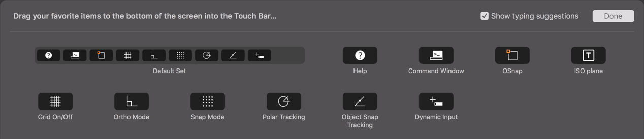

To Customize the Touch Bar
Select from the list of available commands to customize the touch bar.
  1. Select View menu > Customize Touch Bar.
  2. Select from the list of available commands and drag to the bottom of the screen to drop on to the touch bar.
  3. On the touch bar, drag a command to change its position.
  4. Drag the command off the touch bar to remove it.
  5. Click Done to exit.
