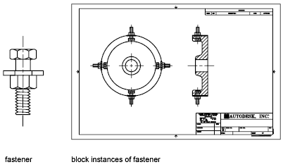

When you insert one drawing file into another drawing, the information from the inserted drawing is saved as a block definition in the block table of the destination drawing. Subsequent references to that block definition can display different position, scale, and rotation settings, as shown in the following illustration.
