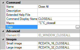

In the Customize tab, Command List pane, select the command to which you want to add a tag.
In the Properties pane, click the Tags field and click the […] button.

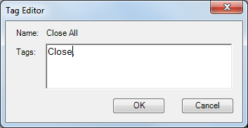

In the Tag Editor dialog box, Tags box, enter the text that represents the tag for the command.
A popup menu displays a list of previously used tags (if present). Click a tag on the menu to use that tag. You can add more than one tag to a command; separate each tag with a comma.
Continue to add another tag by pressing the Left Arrow key and entering another text string.
Click OK.

In the Customize tab, Command List pane, select the command from which you want to remove a tag.
In the Tag Editor dialog box, Tags box, click the tag you want to remove. Press Delete.
Click OK.

In the Customize tab, Command List pane, select the command from which you want to edit a tag.
In the Tag Editor dialog box, Tags box, double-click the tag you want to edit and change the value of the tag.
