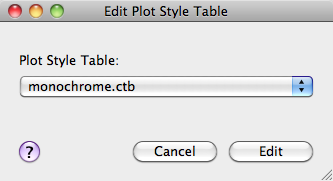

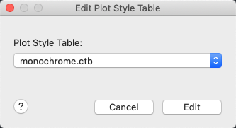

Edit Plot Style Table Dialog Box
Create or edit plot style table files.
PLOTSTYLE (Command)
Menu: Format > Plot Style.
List of Options
The following options are displayed.
Plot Style Table
Displays a list of the available plot style files that can be edited. A plot style is a collection of property settings used in plotting. Along with selecting a plot style to edit from the list, you can also select one of the following:
  • Reveal in Finder. Opens Finder to the folder that contains the listed plot styles. The location in which AutoCAD 2018 locates plot styles can be changed under Printer Support File Path Plot Style Table Search Path on the Application tab of the Application Preferences dialog box (OPTIONS command).
  • New. Displays the Plot Style Table Editor with the default properties for a new plot style. The type of new plot style created depends on the type of plot style being used in the current drawing.
Edit
Displays the Plot Style Table Editor with the properties of the selected plot style.
