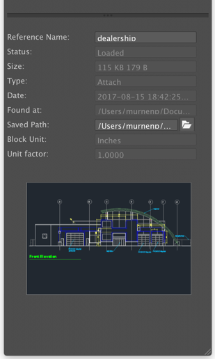

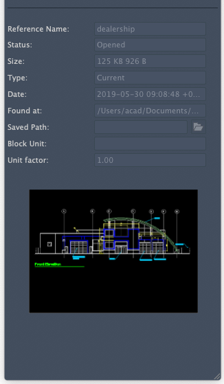

The Details and Preview panel, located at the bottom of the Reference Manager palette, displays information about the selected file reference.
The following options are displayed.
Each file reference shares a common set of properties. Some of the properties can be edited.
Displays the file reference name. This property is editable for all file reference types.
Shows whether the file reference is loaded, unloaded or not found. This property cannot be edited.
Shows the file size of the selected file reference. The size is not displayed for file references that are not found. This property cannot be edited.
Indicates whether the file reference is an attachment or overlay, or the type of raster image file. This property cannot be edited.
However, if the file reference is a DWG, the property can be toggled from the context menu on the upper panel of the Reference Manager.
Displays the last date the file reference was modified. This date is not displayed if the file reference is not found. This property cannot be edited.
Displays the absolute path of the selected file reference. This property cannot be edited.
Displays the save location of the selected file reference. This is where the referenced file is saved and is not necessarily the same as the Found At location. Clicking the Open button displays the Open dialog box where you can select a different path or file name. You can also type directly into the path field. These changes are stored to the Saved Path property if the new path is valid.
If you select a referenced DWG (xref), additional properties are displayed. None of the added image properties can be edited.
If you select a referenced image, additional properties are displayed. None of the added image properties can be edited.
Displays the color system.
The amount of information that is stored in each pixel of a raster image. Higher color depth values produce smoother degrees of shading.
The width of the raster image measured in pixels.
The height of the raster image measured in pixels.
The width and height resolution in dots per inch (dpi).
The width and height of the raster image measured in AutoCAD 2018 units.
The thumbnail preview displays a small image of the selected file reference. If there is no preview available, the text “Preview not available” is displayed.
