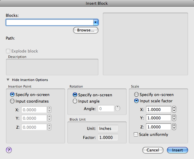

Specifies the name and position of the block or drawing to insert.
INSERT (Command)
Tool Set:
The position of the inserted block depends on the orientation of the UCS.
Specifies the name of a block to insert, or the name of a file to insert as a block.
Opens the Select Drawing File dialog box (a standard file selection dialog box) where you can select a block or drawing file to insert.
Specifies the path to the block.
Explodes the block and inserts the individual parts of the block. When Explode is selected, you can specify a uniform scale factor only.
Component objects of a block drawn on layer 0 remain on that layer. Objects having color BYBLOCK are white. Objects with linetype BYBLOCK have the CONTINUOUS linetype.
Displays the description that was saved with the block.
Displays a preview of the specified block to insert. A lightning bolt icon in the lower-right corner of the preview indicates that the block is dynamic. A
icon indicates that the block is annotative.
Expands or collapses the Insertion Options section to allow you to specify the insertion point, rotation and scale for the block reference being created.
Specifies the insertion point for the block.
Specifies the insertion point of the block using the pointing device.
Sets the X coordinate value.
Sets the Y coordinate value.
Sets the Z coordinate value.
Specifies the scale for the inserted block. Specifying negative values for the X, Y, and Z scale factors inserts a mirror image of a block.
Specifies the scale of the block using the pointing device.
Sets the X scale factor.
Sets the Y scale factor.
Sets the Z scale factor.
Specifies a single scale value for X, Y, and Z coordinates.
Specifies the rotation angle for the inserted block in the current UCS.
Specifies the rotation of the block using the pointing device.
Sets a rotation angle for the inserted block.
