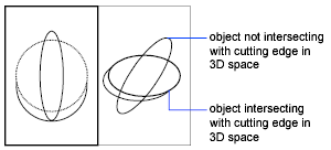

Specifies the projection method used when trimming objects.
Specifies no projection. The command trims only objects that intersect with the cutting edge in 3D space.

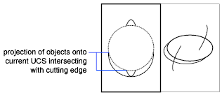

Specifies projection onto the XY plane of the current UCS. The command trims objects that do not intersect with the cutting edge in 3D space.

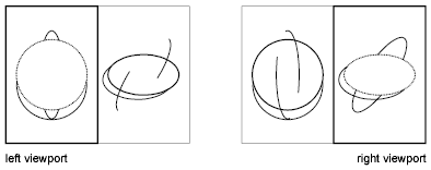

Specifies projection along the current view direction. The command trims objects that intersect the boundary in the current view.
