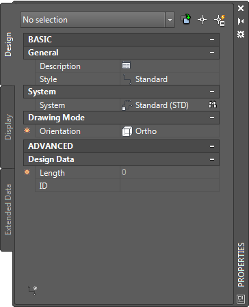

  1. In the Schematic workspace, start the add command by doing one of the following:
    • Open a schematic tool palette, and select a schematic line tool.
      If necessary, scroll to display the tool. Because tools contain pre-configured properties for the objects they create, you might not need or be able to specify some of the schematic line properties referenced in this procedure.
    • Click Home tabBuild panelSchematic Line.
    • Enter slineadd.
    Note: On the Properties palette, indicates a property is available only when you are adding schematic lines, not when you are modifying them.
  2. Expand Basic, and for Description, click , enter a description for the schematic line, and click OK.
  3. For Style, select a schematic line style.
    You can select from the styles in the current drawing.
  4. If you want to change the current system, for System, select the system to which the schematic line belongs.
    You can select from the systems in the current drawing.
    Tip: You can create schematic line tools that reference styles and systems in content libraries (DWG files).
  5. For Orientation, select Ortho.
  6. Expand Advanced, and for ID, select or enter an ID designation.
    The currently selected schematic line style determines the list of available IDs.
  7. In the drawing, specify the start point for the line, or use schematic AutoCAD MEP snaps to connect the line to a symbol or another line.
  8. Continue to specify points to draw the schematic line.
  9. If necessary, on the Properties palette, modify the schematic line properties, and add additional lines.
  10. Press Enter to end the add command.
