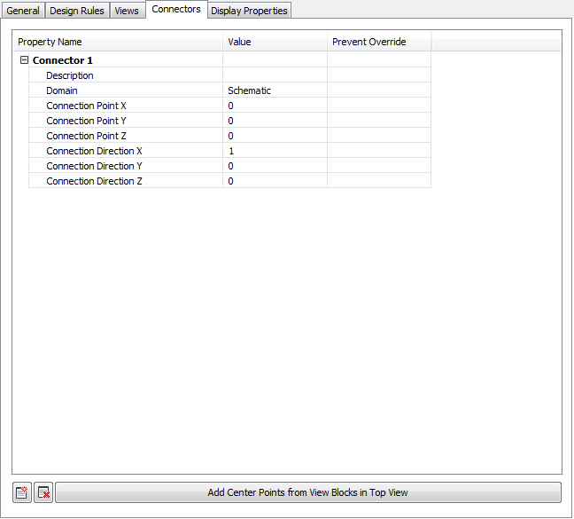

- Click the Connectors tab.
- For Description, enter a descriptive name, such as Air_Supply.
- For Domain, select a domain. For some types of styles, only a single domain is available.
- Specify values for connection points X, Y, and Z, or click Add Center Points from View Blocks in Top View to create a centered connector.
Danger: Use caution when modifying the connection points on connectors or removing connectors. Either can break the connectivity between objects because the connector is modified in or removed from all instances of the style in the drawing.
- If you want to add a connector, click
, and configure the connector properties.
- If you want to remove a connector, select the connector, and click
- Click OK.
