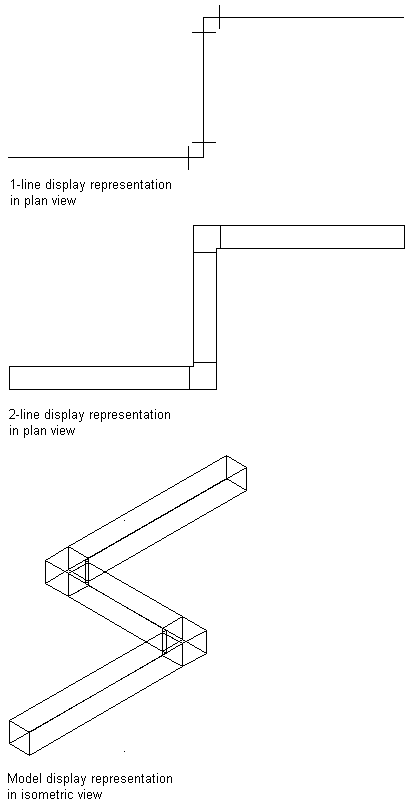

The AutoCAD MEP display system controls how objects appear in a viewport. By specifying the objects for display and the direction from which to view them, you can produce different displays, such as plan layouts, 3D models, isometric riser diagrams, and schematic diagrams. Establishing standard displays helps maintain consistency across multiple drawings.
Three main components comprise the AutoCAD MEP display system:
These components are hierarchical in nature. Each display configuration contains some display sets, and each display set contains some display representations. The components work together to create the display system as follows:
Most AutoCAD MEP objects have 1 Line, 2 Line, Model, and Plan display representations. This is because these are the most common design scenarios that require different views of a building system.
Some building systems objects, such as label curve objects and schematic objects, have only a general display representation because the display of these objects does not change in different views.
