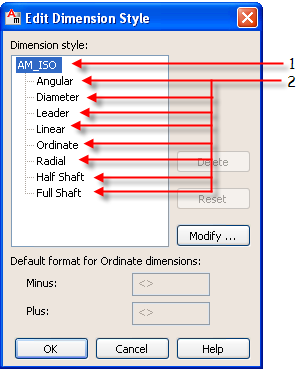

Base Dimension Styles and Substyles
The dimension styles associated with a drafting standard consists of a base dimension style (1 in the illustration), which defines the basic settings for dimensions for that standard, and substyles (2 in the illustration), which explicitly define styles for the different dimension types. In most cases, substyles are identical to the base style. In some cases, when it is required to enforce a unique characteristic on a dimension type, the default settings for that dimension style have at least one setting that is different from the base dimension style.
When you change the base dimension style settings, the changes apply to the substyles. However, if the substyle setting does not match the base dimension style setting before the change (For example, if you override the setting in the substyle), the setting does not apply to that substyle.
AutoCAD Mechanical provides options to reset a substyle in the Dimension Styles dialog box. When you reset the substyle, it is synchronized with the current base dimension style, removing all user-defined overrides on that substyle. Overrides that are required to enforce the unique characteristics of the corresponding dimension type, do not reset.
