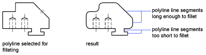

You can fillet all vertexes of a polyline at the same time.
Note:
Only the segments long enough to accommodate the fillet is filleted.

Enter P for polyline.

Select the polyline.
