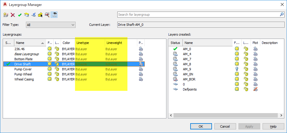

Enhancements to Layergroup Manager and Mechanical Layer Manager
In the Layergroup Manager, you can now specify the layergroup linetype and lineweight, just like how you specify the layergroup color.
In the Mechanical Layer Manager you can choose to override the layer linetype and lineweight with that of the layergroup.
