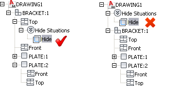

In a mechanical structure-enabled drawing, the position of the hide situation on the mechanical structure is important.
For example, if you create a hide situation between two parts of a subassembly, the most appropriate position to store the hide situation is on the subassembly. If you insert another instance of the subassembly in the drawing, the hide situation also inserts automatically because the hide situation is an integral part of the subassembly. Alternatively, if you store the hide situation directly under the drawing name (the root node of the browser) the hide situation does not show in any new instances you create because the subassembly does not store the hide situation.
