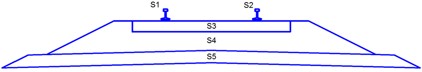

The RailSingleTrack subassembly is used to insert the rails, ties, ballast, and subballast for a single-track railroad.
It should be followed with a Daylight subassembly on the left and right sides to close to existing ground in cut and fill situations. It is capable of responding to rail cant.
By default, the attachment point is at the centerline between the rails. The track can be moved relative to this point using the subassembly parameters.

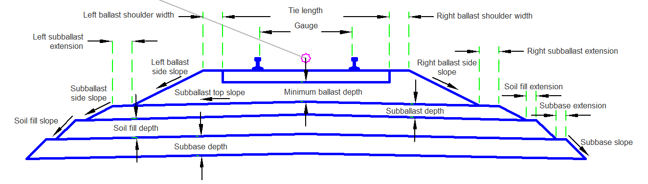

Parameter |
Description |
Type |
Default |
| Measure Cant At | Determines whether the elevation difference between rails takes place between the gauge line (face) of each rail or CL of each rail. | Selection List:
CL Rail to CL Rail |
| Default Cant | The default elevation difference between rails. The value is positive when the right rail is higher than the left and negative when the right rail is lower than the left. This value is applied in layout mode and is helpful for observing how the subassembly reacts to different cant values. This value is overridden by cant when it is present via the baseline alignment. | Numeric | 0 |
| Gauge | The distance between the inside faces of the rails. | Numeric, non-negative |
56.5" 1435 mm |
| Rail Head Width | Width of the rail head. | Numeric, non-negative |
2.72" 69 mm |
| Rail Depth | Depth of rail from top of rail to top of tie plate. | Numeric, non-negative |
6.625" 168 mm |
| Rail Base Width | Width of the base of the rail. | Numeric, non-negative |
5.5" 140 mm |
| Tie Plate Thickness | Thickness of the tie plate which is also the distance from the bottom of the rail to the top of the tie. | Numeric, non-negative |
1" 25 mm |
| Rail Base to Ballast | Distance from the bottom of the rail to the top of the ballast. If this value is equal to the tie plate thickness, then the top of the ballast is flush with the tops of the ties. | Numeric, non-negative |
1" 25 mm |
| Tie Length | Length of the tie (also known as sleeper). | Numeric, non-negative |
8.5 ft 2.59 m |
| Tie Depth | Depth of tie . | Numeric, non-negative |
7" 178 mm |
| Minimum Ballast Depth | The minimum vertical distance between the bottom of the tie and the top of the subballast. The location of this minimum distance changes at different stages in cant. See "Behavior" below. | Numeric, non-negative |
12" 305 mm |
| Ballast Shoulder Width (Left and Right) | The distance from the end of the tie to the beginning of the ballast side slope. | Numeric, non-negative |
12" 305 mm |
| Ballast Side Slope (Left and Right) | The slope of the side of the ballast material. The slope of the top of the ballast material matches the slope of the tie that results from cant. | Slope, non-negative | 2:1 |
| Subballast Depth | The depth of the subballast material | Numeric, non-negative |
8" 203 mm |
| Subballast Top Slope | The top slope of the left and right sides of the subballast with the centerline of the subassembly as the hinge point. | Slope, non-negative | 40:1 |
| Subballast Extension (Left and Right) | The distance from the toe of the ballast material to the beginning of the side slope of the subballast material. | Numeric, non-negative |
12" 305 mm |
| Subballast Side Slope (Left and Right) | The slope of the side of the subballast material. | Slope, non-negative | 2:1 |
| SubBase Extension (Left and Right) | The distance from the toe of the subballast material to the beginning of the side slope of the subbase material. | Numeric, non-negative |
0.5 ft 0.15 m |
| SubBase Slope | The slope of the side of the subbase material. | Slope, non-negative | 1:1 |
| SubBase Depth | The depth of the subbase material. | Numeric, non-negative |
1 ft 0.30 m |
| Soil Fill Depth | The depth of the soil fill material. | Numeric, non-negative |
1 ft 0.30 m |
| Soil Fill Slope | The slope of the side of the soil fill material. | Slope, non-negative | 1:1 |
| Soil Fill Extension (Left and Right) | The distance from the toe of the subbase material to the beginning of the side slope of the soil fill material | Numeric, non-negative |
0.5 ft 0.15 m |
| Omit Rails | Prevents the rail points, links, and shapes from being drawn. | Yes/No | No |
| Omit Tie | Prevents the tie points, links, and shapes from being drawn. | Yes/No | No |
| Omit Ballast | Prevents the ballast points, links, and shapes from being drawn. If this option is set to "Yes" then the subballast is also not drawn. | Yes/No | No |
| Omit Subballast | Prevents the subballast points, links, and shapes from being drawn. If the Omit Ballast option is set to "Yes" then the subballast is not drawn regardless of this setting. | Yes/No | No |
| Omit SubBase | Prevents the subbase points, links, and shapes from being drawn. If the Omit Ballast or subballast option is set to "Yes" then the subballast is not drawn regardless of this setting. | Yes/No | No |
| Omit Soil Fill | Prevents the soil fill points, links, and shapes from being drawn. If the Omit Ballast, subballast, or subbase option is set to "Yes" then the soil fill is not drawn regardless of this setting. | Yes/No | No |

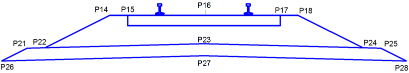

| P1, P4 - P13 | Rail | Rail |
| P2 | Cl_Rail | Centerline of Rail |
| P3 | Gauge_Line, Rail | Gauge line (inside edge of top of rail) |
| P14, P18, P19, P23 | Top_Edge_Ballast | Top edge of the ballast material |
| P15, P17, P20, P22 | Tie | Top corner of tie |
| P16, P21 | CL_Tie | Centerline of tie at top |
| P26, P30 | Top_Edge_Subballast | Top edge of the subballast material |
| P27, P29 | Bottom_Edge_Ballast | Bottom edge of the ballast material |
| P28 | Top_Subballast | Top of subballast material at centerline |
| P31, P33 | Bottom_Edge_Subballast | Bottom edge of the subballast material |
| P32 | Bot_Subballast | Bottom of subballast material at centerline |

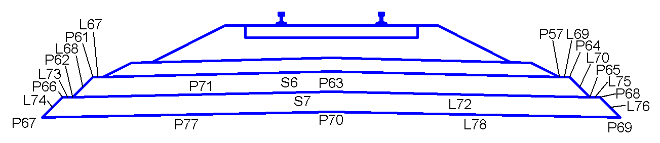

| P63 | Bottom_SoilFill | Bottom_SoilFill |
| P64 | Top_Edge_SoilFill | Top_Edge_SoilFill |
| P62, P65 | Bottom_Edge_SoilFill | Bottom_Edge_SoilFill |
| P66 | Top_Edge_SubBase | Top_Edge_SubBase |
| P67 | Bottom_Edge_SubBase | Bottom_Edge_SubBase |
| P68 | Top_Edge_SubBase | Top_Edge_SubBase |
| P69 | Bottom_Edge_SubBase | Bottom_Edge_SubBase |
| P70 | Bottom_SubBase | Bottom of SubBase |

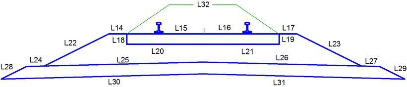

| L1, L2 | Top_Rail, Rail | Top of rail |
| L3 - L13 | Rail | Rail |
| L14, L17, L22, L23 | Ballast, Top | Top of ballast |
| L15, L16 | Tie, Top_Tie | Top of tie |
| L18 - L21 | Tie | Tie |
| L24, L27 - L29 | Subballast, Top | Top of subballast |
| L25, L26 | Ballast, Subballast | Ballast and subballast |
| L30, L31 | Subballast, Datum | Bottom of subballast |
| L32 | Ballast, Ballast_Between_Ties | Ballast material in open space between ties. Can also be used when ties are omitted. |
| L67 - L70 | Top, SoilFill | SoilFill |
| L71, L72 | SoilFill, SubBase | SubBase |
| L73 - L76 | Top, SubBase | SubBase |
| L77, L78 | SubBase, Datum | SubBase |
| S1, S2 | Rail | Rails |
| S3 | Tie | Tie |
| S4 | Ballast | Ballast |
| S5 | Subballast | Subballast |
| S6 | SoilFill | SoilFill |
| S7 | SubBase | SubBase |
