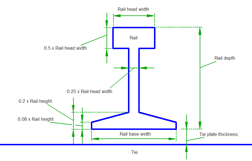

Rail Head Width
Width of the rail head.
Numeric, non-negative
2.72"
69 mm
Rail Depth
Depth of rail from top of rail to top of tie plate.
6.625"
168 mm

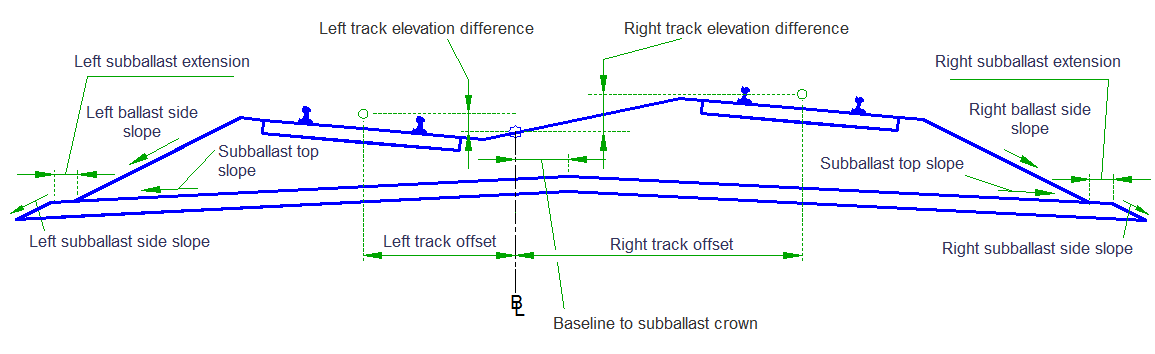

Left Ballast Shoulder Width
The distance from the end of the tie to the beginning of the ballast side slope.
1 ft
0.30 m
Right Ballast Shoulder Width
1 ft
0.30 m
Left Ballast Side Slope
The slope of the side of the ballast material. The slope of the top of the ballast material matches the slope of the tie that results from cant.
Slope, non-negative
2:1
Right Ballast Side Slope
Slope, non-negative
2:1
Subballast Depth
The depth of the subballast material.
8"
203 mm
Baseline to Subballast Crown
The offset from the baseline to the crown of the subballast.
Numeric
10 ft
3 m
Subballast Top Slope
The top slope of the left and right sides of the subballast with the centerline of the subassembly as the hinge point.
Slope, non-negative
40:1
Subballast Extension (Left and Right)
The distance from the toe of the ballast material to the beginning of the side slope of the subballast material.
12"
0.30 m
Subballast Side Slope
The slope of the side of the subballast material.
Slope, non-negative
2:1

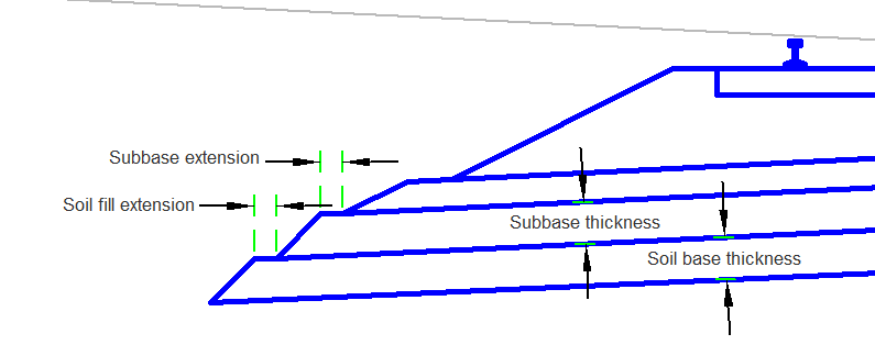

SubBase Slope
The slope of the side of the SubBase material.
Slope, non-negative
1:1
SubBase Extension
The distance from the toe of the subballast material to the beginning of the side slope of the SubBase material.
0.5 ft
0.150 m
SubBase Depth
The depth of the SubBase material.
12"
300 mm
Omit SubBase
Prevents the SubBase points, links, and shapes from being drawn. If the Omit Ballast, Omit Subballast, or Omit Soil Fill option is set to "Yes" then the SubBase is not drawn regardless of this setting.
Yes/No
No
Soil Fill Slope
The slope of the side of the Soil Fill material.
Slope, non-negative
1:1
Soil Fill Depth
The depth of the Soil Fill material.
12"
300 mm
Soil Fill Extension
The distance from the toe of the soil fill material to the beginning of the side slope of the Subballast material.
0.5 ft
150 mm

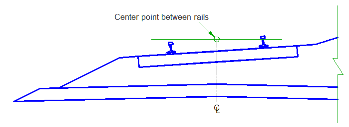

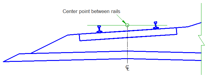

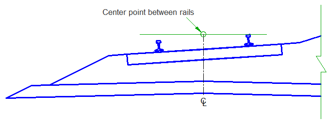

When rail cant information is applied to the alignment baseline, the rails will rotate accordingly. The point about which they rotate will depend on the setting for Pivot Method contained in the cant information for the alignment. If the Pivot Method is set to Low Side Rail, then the rail on the inside of the curve is held at track elevation and the elevation of the outside rail is adjusted an amount equal to the cant value.
Case 1: Pivot Method set to Low Side Rail
Case 2: Pivot Method set to High Side Rail
If the Pivot Method is set to High Side Rail, then the rail on the outside of the curve is held at track elevation and the elevation of the inside rail is adjusted an amount equal to the cant value.
Case 3: Pivot Method set to Center Baseline
If the Pivot Method is set to Center Baseline, then the both rails are adjusted an amount equal to half the cant value, the outside rail upward and inside rail downward.
For all cases, the Minimum Ballast Depth value is applied at the location of the minimum clearance between the tie and subballast. The subballast top slope is controlled independently by the Subballast Top Slope parameter. The location of the subballast crown is controlled by the Baseline to Subballast Crown parameter.

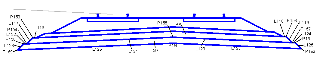

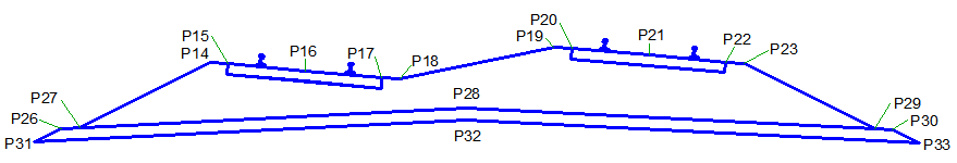

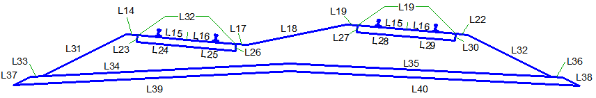

Point, Link, and Shape Codes
The following table lists the point, link, and shape codes for this subassembly that have codes assigned to them. Point, link, or shape codes for this subassembly that do not have codes assigned are not included in this table.
Point, Link, or Shape
Code
Description
P1, P4 - P13 Rail Rail
P2 Cl_Rail Centerline of rail
P3 Gauge_Line, Rail Gauge line (inside edge of top of rail)
P14, P18, P19, P23 Top_Edge_Ballast Top edge of the ballast material
P15, P17, P20, P22 Tie Top corner of tie
P16, P21 CL_Tie Centerline of tie at top
P26, P30 Top_Edge_Subballast Top edge of the subballast material
P27, P29 Bottom_Edge_Ballast Bottom edge of the ballast material
P28 Top_Subballast Top of subballast material at centerline
P31, P33 Bottom_Edge_Subballast Bottom edge of the subballast material
P32 Bot_Subballast Bottom of subballast material at centerline
P153 Top_Edge_SoilFill
P154 Bottom_Edge_SoilFill
P155 Bottom_SoilFill
P156 Top_Edge_SoilFill
P157 Bottom_Edge_SoilFill
P158 Top_Edge_SubBase
P159 Bottom_Edge_SubBase
P160 Bottom_SubBase
P161 Top_Edge_SubBase
P162 Bottom_Edge_SubBase
L1, L2 Top_Rail, Rail Top of rail
L3 - L13 Rail Rail
L14, L17, L22, L23 Ballast, Top Top of ballast
L15, L16 Tie, Top_Tie Top of tie
L18 - L21 Tie Tie
L24, L27 - L29 Subballast, Top Top of subballast
L25, L26 Ballast, Subballast Ballast and subballast
L30, L31 Subballast, Datum Bottom of subballast
L32 Ballast, Ballast_Between_Ties Ballast material in open space between ties. Can also be used when ties are omitted.
L116 - L119 Top, SoilFill Soil fill
L120 - L121 SoilFill, SubBase Soil fill
L122 - L125 Top, SubBase SubBase
L126 - L127 SubBase, Datum SubBase
S1, S2 Rail Rails
S3 Tie Tie
S4 Ballast Ballast
S5 Subballast Subballast
S6 SoilFill Soil fill
S7 SubBase SubBase
Coding Diagrams
