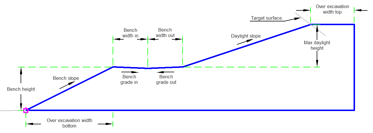

The BasicBenchWithOverExcavation subassembly inserts links to create cut or fill catch slopes with repeating benches as needed.
You specify a max daylight height and if the vertical distance between the insertion point and the target surface is higher than the specified max daylight height, then benching occurs using specified bench height, slope, grade, and width; this operation repeats itself until the target surface is found.
Once the target surface is found, an over excavation width is applied at the top where the daylight link meets the target surface. If the vertical distance between the insertion point and the target surface is lower than the max daylight height, then there is no benching and a daylight link is placed.
If the target surface is not found after the operation was repeated a specified number of times, the subassembly will finish using a daylight link until it reaches the target surface.

Input Parameters
Note: All dimensions are in meters or feet unless otherwise noted. All slopes are in run-over-rise form (for example, 4 : 1) unless indicated as a percent slope with a “%” sign.
Parameter
Description
Type
Default
Side
Specifies which side to place the subassembly.
Left / Right
Right
Max Daylight Height
The maximum allowable height for the cut and fill daylight link without benching.
Numeric
15.0 ft
4.5 m
Bench Height
The maximum allowable height for a bench before a new bench.
Numeric
10.0 ft
3.0 m
Bench Slope
The slope between benches.
Numeric, positive
1 (: 1)
Bench Grade In
The +/- % slope of the bench. Positive slopes are upward in the direction of increasing offset.
Numeric
4 (%)
Bench Width In
The width of the bench to the bench flowline.
Numeric, positive
4 ft
1.2 m
Bench Grade Out
Numeric
4 (%)
Bench Width Out
The width of the bench from the bench flowline.
Numeric
4 ft
1.2 m
Daylight Slope
The daylight slope.
Numeric, positive
2 (: 1)
OverExcavation Width Top
The width of the overexcavation from the daylight.
Numeric, positive
5 ft
1.5 m
OverExcavation Width Bottom
The width of the overexcavation from the hinge point.
Numeric, positive
10 ft
3 m

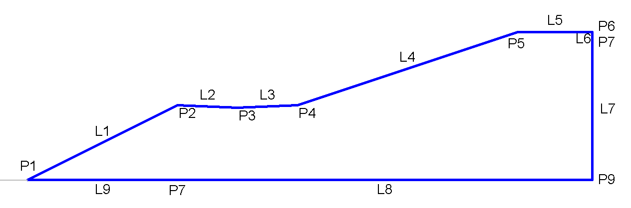

P1 Top, Datum
P2, P3, P5, P6 Top
P4 Top, FL Flowline of the bench.
P7 Top, Wall Back edge of over excavation width at the top of the daylight link.
P8, P9, P10 Datum
L1 - L6 Top
L7 - L10 Datum
Coding Diagram
