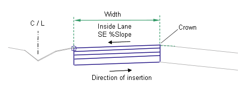

This subassembly creates a cross-sectional representation of a travel lane that is being inserted from the inside edge of pavement towards the crown point.
Note: This subassembly does not support superelevation axis of rotation pivot points other than Centers. This subassembly has been deprecated and is available only in the Corridor Modeling Catalogs. The LaneSuperelevationAOR subassembly has all the functionality of this subassembly, and it supports superelevation axis of rotation pivot points.
It uses the Outside Lane superelevation slope value for the corridor model’s baseline alignment. The pavement structure follows the standards described in “Pavement Structure on Paved Sections” in the AutoCAD Civil 3D Help.
The attachment point is at the inside edge of lane on the finish grade surface. This component can be attached to either the left or right side.

Behavior
The Inside Lane superelevation slope is obtained from the superelevation specifications for the baseline alignment, and the algebraic sign of this value is reversed. If inserting to the left, the Right Outside Lane Slope is obtained and reversed; if inserting to the right, the Left Outside Lane Slope is obtained and reversed. Starting at the attachment point, a finish grade surface and parallel subgrade are inserted using the given width, depth, and the reverse superelevation slope. Vertical links close the shape at either end of the lane.
If an offset horizontal alignment name is assigned to the Width during corridor modeling, the width of the lane will vary to match the offset of the alignment.
Layout Mode Operation
In layout mode, this subassembly displays the finish, base, and subbase links for the given width and depths at a -2% slope.
Point, Link, and Shape Codes
The following table lists the point, link, and shape codes for this subassembly that have codes assigned to them. Point, link, or shape codes for this subassembly that do not have codes assigned are not included in this table.
Point, Link, or Shape
Code
Description
P1
ETW
Inside edge of lane on finish grade
P2
Crown
Outside edge of lane (at the crown point) on finish grade
P3
ETW_Pave1
Inside edge of lane on Pave1
P4
Crown_Pave1
Outside edge of lane on Pave1
P5
ETW_Pave2
Inside edge of lane on Pave2
P6
Crown_Pave2
Outside edge of lane on Pave2
P7
ETW_Base
Inside edge of lane on the base layer
P8
Crown_Base
Outside edge of lane on the base layer
P9
ETW_Sub
Inside edge of lane on the subbase layer
P10
Crown_Sub
Outside edge of lane on the subbase layer
L1
Top, Pave
Finish grade surface
L2
Pave1
L3
Pave2
L4
Base
L5
SubBase
Datum
S1
Pave1
S2
Pave2
S3
Base
S4
SubBase
Coding Diagram
