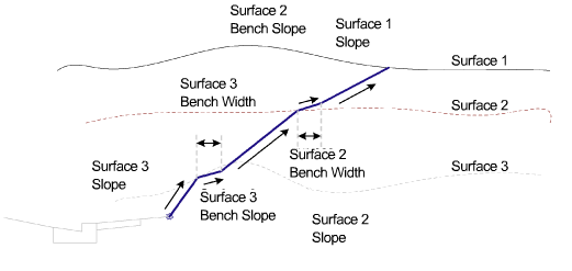

This subassembly lets you specify three surface layers and cut slopes for each material type.
When transitioning between types, a bench can also be inserted.
The attachment point is at the inside edge of the initial cut or fill slope. This component can be attached to either the left or right side.
Note: All dimensions are in meters or feet unless otherwise noted. All slopes are in run-over-rise form (for example, 4 : 1) unless indicated as a percent slope with a “%” sign.

In a fill situation, a daylight link is inserted with a slope based on the fill slope input parameter to surface 1. In cut, the subassembly first checks to determine if it is below surface 3 by applying the surface 3 slope, and checking for intersection. This process repeats for each additional surface. Optionally, between the surfaces optional transitions can be added at the surface changes. The bench width and slope for the surface that was just intersected will be used.
In AutoCAD Civil 3D 2010 and previous versions, the Material Thickness parameter was measured vertically. In AutoCAD Civil 3D 2011 and later, this parameter is measured perpendicular to the link. Therefore, if you open a drawing containing these subassemblies that was created in AutoCAD Civil 3D 2010 or prior in AutoCAD Civil 3D 2011 or later, and then rebuild the corridor(s), this parameter will be changed to reflect the new behavior. Any volume reports that use this subassembly will be updated to reflect the new behavior.
This subassembly displays in layout mode using the input parameters for Surface 1 Slope and Fill Slope.
