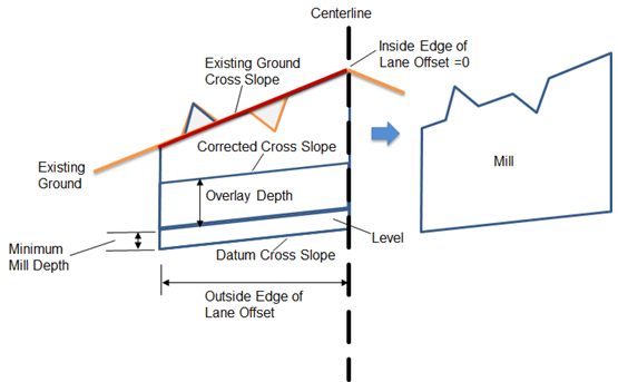

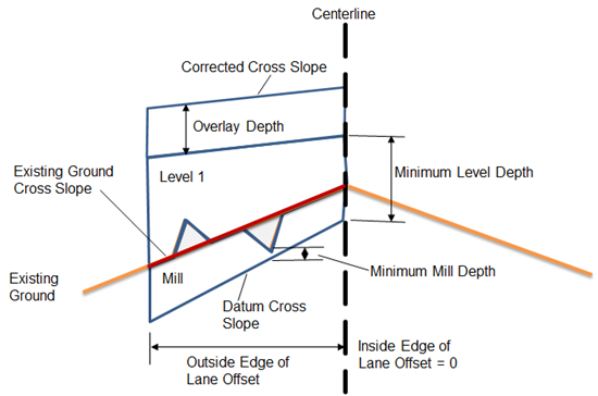

Behavior
  • Areas must be provided for all layers.
  • The Leveling area is equal to the areas of Level 1 + Mill layers combined.
  • The Milling Area layer is represented in the diagram below as Mill.
  • Minimum Level Depth is equal to the area from the top of the milling layer to the bottom of the overlay layer.
Special Case
When Use Profile is selected in Profile Options, the overlay is located below the existing ground.
Behaviors:
  • Milling will continue Minimum Mill Depth downwards from bottom of Overlay
  • The area of Minimum Mill Depth will be filled as Level area.
  • Total Mill area is from the Datum layer to the Existing Ground layer.
Note: The same results will likely occur when Lock to Previous is selected in Use Profile Options.

S1 Overlay Area between the top and bottom of overlay. This area overlaps the leveling area as shown in the coding diagram below
S2 Level Area above existing surface and below the bottom of overlay (leveling case)
S3 Mill Area between bottom of existing surface and bottom of mill (milling case)
Note: Multiple Links will occur when the Existing Ground surface is not smooth. This is shown in the image below by L10.
