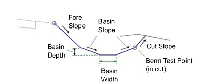

This subassembly is similar to the DaylightBasin subassembly with the following additional behaviors:

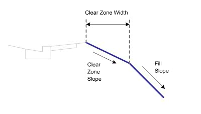

The berm is optional in fill conditions. If no berm is included, a clear zone slope is added, and then a daylight fill slope is added.
The Ditch Width can be controlled by using an optional alignment. Berm Width and Height can be controlled by using an alignment and a profile respectively. In addition, the Place Lined Material needs to include all links of the daylight assemblies from the hinge point out to the daylight to existing ground.
The attachment point is at the inside edge of the basin foreslope. This component can be attached to either the left or right side.
Note: All dimensions are in meters or feet unless otherwise noted. All slopes are in run-over-rise form (for example, 4 : 1) unless indicated as a percent slope with a “%” sign.

This subassembly builds the links for the basin foreslope and the basin out to the basin test point. If a profile is given, the width of the foreslope varies to hold to the basin profile. If the basin test point is in cut, the daylight intercept is calculated on the target surface at the given cut slope.
If it is in fill, and Berm is set to Include, a top-of-berm link is added, and the daylight intercept is calculated on the target surface at the given Fill Slope. The daylight link is not inserted if Omit Daylight Link is set to True. If the top-of-berm link intersects the target surface, the section is terminated at the intersection.
If it is in fill, and Berm is set to Omit, a link is added from the attachment point at the Clear Zone Slope until the Clear Zone Width is met. Then a daylight link is added to the target surface at the fill slope specified. If the clear zone link intersects existing ground, it will stop at this intersection point.
Like other daylight subassemblies, this subassembly optionally lets you add a lined material. You can specify three ranges of slopes. Material type 1 is applied if the slope of the links is up to the specified slope value. From slope 1 to slope 2, the second type of material is applied. Similarly, if the slopes of links fall within slope 2 and slope 3 values, then material 3 is applied. If the link slopes are flatter than slope limit 3, then no material is applied.
If a lined material is added to the subassembly, then parallel links are added to the daylight links with specified thickness. This thickness parameter (for example, Material 1 Thickness) is measured perpendicular to the link. Bottom level links are coded with Datum, and daylight links are coded with Top. Shapes enclosed by these materials are coded with material name (Material 1 Name, Material 2 Name, or Material 3 Name).
In AutoCAD Civil 3D 2010 and previous versions, the Material Thickness parameter was measured vertically. In AutoCAD Civil 3D 2011 and later, this parameter is measured perpendicular to the link. Therefore, if you open a drawing containing these subassemblies that was created in AutoCAD Civil 3D 2010 or prior in AutoCAD Civil 3D 2011 or later, and then rebuild the corridor(s), this parameter will be changed to reflect the new behavior. Any volume reports that use this subassembly will be updated to reflect the new behavior.
In layout mode, this subassembly draws the foreslope, basin side slopes, and basin bottom with the given input parameter values. Both the cut and fill condition links are shown in dashed lines, with the daylight links extended outward, for a width of 3 meters (or 10 feet) at the given slopes. The daylight links terminate in arrowheads pointing outwards.
