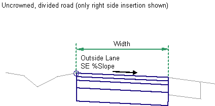

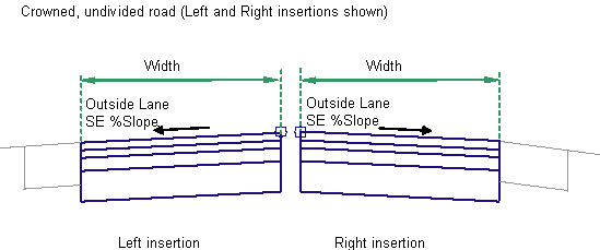

This subassembly inserts a travel lane, applying the Outside Lane superelevation slope value, and widens the pavement at superelevated regions.
It can be used for most undivided roads, or divided roads with no lane slope break on either side. It may also be used for the outside lanes of divided crowned or broken-back highways. The pavement structure follows the standards described in “Pavement Structure on Paved Sections” in the AutoCAD Civil 3D Help. The only difference between this subassembly and the LaneOutsideSuper subassembly is that this subassembly also widens the pavement width in superelevated regions of the corridor.
The attachment point is (a) at the inside edge of lane on finished grade, if the insertion point is Crown, or (b) at the outside edge of travel way,if the insertion point is at the edge of travel way. This component can be attached to either the left or right side.

The Outside Lane superelevation slope is obtained from the superelevation specifications for the baseline alignment. Starting at the attachment point, a finish grade surface and parallel subgrade are inserted using the given width, depth, and the superelevation slope. Vertical links close the shape at either end of the lane.
