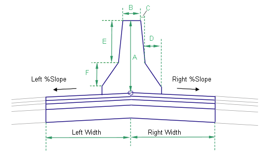

This subassembly inserts surfaces to define a flush median with an optional New Jersey Barrier.
The pavement structure follows the standards described in “Pavement Structure of Paved Sections" in the AutoCAD Civil 3D Help.
The attachment point is at the center of median on the finish grade surface. This component inserts to the left and right side simultaneously.
Note: All dimensions are in meters or feet unless otherwise noted. All slopes are in run-over-rise form (for example, 4 : 1) unless indicated as a percent slope with a “%” sign.

Dimension A (mm or inches) |
Height of the barrier at the center of median |
Numeric, positive |
810 mm 32 in |
Dimension B (mm or inches) |
As shown in diagram |
Numeric, positive |
232 9 in |
Dimension C (mm or inches) |
Numeric, positive |
59 mm 2 in |
Dimension D (mm or inches) |
Numeric, positive |
125 mm 5 in |
Dimension E (mm or inches) |
Numeric, positive |
557 mm 22 in |
Dimension F (mm or inches) |
Numeric, positive |
178 mm 7 in |

The pavement structure links are inserted outward left and right of the attachment point for the given widths and slopes. If the Include Barrier value is True, a New Jersey barrier is inserted symmetrically about the median centerline. If alignments are given as target parameters for the Left and Right Widths, the widths are adjusted to tie to the alignment offsets at each station along the corridor.

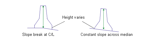

If the median is in superelevation with a single constant slope across the entire median, the top of the barrier is slanted to match the median slope. Otherwise the top of the barrier remains horizontal. In all cases, the barrier height (Dimension A) is held constant at the centerline of the barrier.
This subassembly works only with Roadway Types that have a Pivot Method of Median Edges and a Median Treatment of Maintain Median Shape. If you use this subassembly with any other Pivot Method or with Distorted Median Treatment, it will produce a result equivalent to Median Edges with Maintain Median Shape.
In layout mode, this subasssembly displays all pavement links using the width and depth input parameters at a -2% slope. If Include Barrier is True, the barrier is displayed with the given dimensions.
