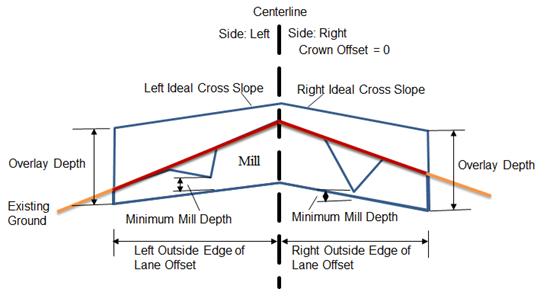

OverlayMillCrown
This subassembly adds an overlay layer on top of an existing crowned roadway with a milling layer added as required.
The attachment point is the crown point of the overlay layer with finished ground cross slope.

Behavior
This subassembly assumes that no leveling layer is added. Flapping must be within tolerance to meet minimum mill. The elevation at the crown will meet both sides.
