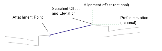

Behavior
A link is added from the attachment point to the given offset and elevation.
Layout Mode Operation
In layout mode, this subassembly displays a horizontal link using the given Offset input parameters as the width.
Point, Link, and Shape Codes
None.
Coding Diagram
