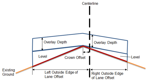

This subassembly overlays an existing crowned roadway, with a leveling layer added above the existing ground as required.
The attachment point is the crown point of the overlay layer with finished ground cross slope.

Crown Offset Positive or negative offset at the crown point Numeric 0.000m (0.00 ft)

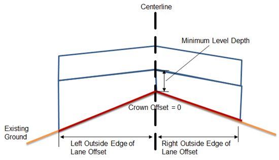

Crown Use Profile Options Select to tie the inside edge of overlay to a profile, or adjust crown point elevation to minimum level depth User Defined Minimum Level Depth

Outside Edge of Existing Left Lane This is the end point for calculating existing ground slope for the left lane Numeric -12.000m (-12.000 ft)
Outside Edge of Existing Right Lane This is the end point for calculating existing ground slope for the right lane Numeric 12.000m (12.000 ft)
Overlay Depth Depth of the overlay layer Numeric, positive 0.300m (0.300 ft.

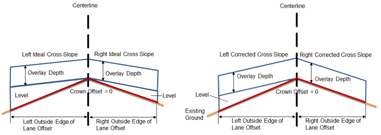

Right and Left Overlay Slope Options Specifies right and left overlay slope options
Tip: Flapping is a term used to describe how the Corrected Cross Slope for an overlay in a rehab subassembly is calculated. Flapping outcomes are different, relative to the Slope Tolerance and the Slope Difference between existing ground cross slope and ideal cross slope. If the Slope Difference is less than the Slope Tolerance for the subassembly, then the use case is considered 'within tolerance'. If the Slope Difference is greater than the Slope Tolerance for the subassembly, then the use case is considered "without tolerance."
Note: Slope Tolerance is an absolute value. Therefore, for either a Slope Difference of 0.4% or -0.4%, both have an absolute value of 0.4%. If the Slope Tolerance is 0.5%, the 0.4% absolute Slope Difference would be considered within tolerance.
  • User Defined With Flapping
    Flapping specifies how the Corrected Cross Slope will be calculated, relative to the slope tolerance for the subassembly
    • Flapping Within Tolerance:
      Corrected Cross Slope will be set as close as possible to the Existing Ground Cross Slope and will also attempt to meet Minimum Level Depth
    • Flapping Without Tolerance:
      Corrected Cross Slope will be set as close as possible to the Existing Ground Cross Slope within Slope Tolerance
  • User Defined Without Flapping
    Flapping specifies how the Corrected Cross Slope will be calculated, relative to Slope Tolerance for the subassembly
      Corrected Cross Slope will be set equal to Ideal Cross Slope
      Corrected Cross Slope will be set as close as possible to the Ideal Cross Slope, within Slope Tolerance.
  • Outside/Inside Lane Superelevation
    Outside or Inside Lane Superelevation will replace Ideal Cross Slope. Corrected Cross Slope values for the overlay layer will be defined by the superelevation table for the section instead of the Ideal Cross Slope.
    Note: If Outside/Inside Lane Superelevation is chosen but the alignment for the rehab corridor does not have a superelevation table defined, Ideal Cross Slope will be used instead.
  • Match Slope
    The Corrected Cross Slope is always set equal to Existing Ground Slope
  • Use Ideal Cross Slope
    The Corrected Cross Slope Slope is always set equal to Ideal Cross Slope

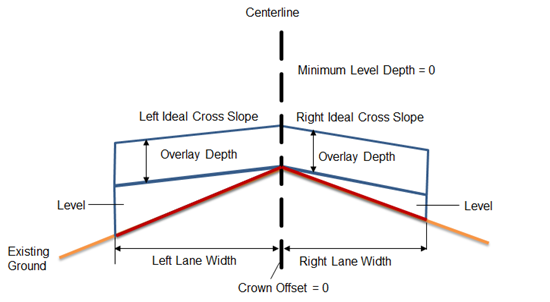

Left Ideal Cross Slope Specifies user defined Ideal Cross Slope for the finished ground profile of the left lane Numeric -2.00%
Left Minimum Level Depth The minimum level depth between the existing surface and the bottom of the left overlay layer Numeric, positive 0.300m (0.300 ft)

Left Lane Width The left lane width, determined by the offset of the outside edge of the left lane from the inside edge of left lane Numeric, negative -12.000m (-12.000 ft)
Right Lane Width The right lane width, determined by the offset of the outside edge of the right lane from the inside edge of right lane Numeric, positive 12.000m (12.000 ft)

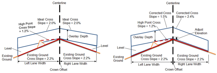

Flapping within Tolerance:
Note: Because the slope difference between the existing ground cross slope and the ideal cross slope is within slope tolerance, the two sides of the road will output different corrected cross slopes relative to the existing ground (EG) surface cross slope for each side of the road. Each side of the road will have corrected cross slope set as close to the existing ground cross slope as possible.
Minimum Level Depth
Note: The minimum level depth represents the minimum depth of the leveling layer, measured between the existing ground high point and the bottom of the overlay layer.

Left Side Input Value
High Point Cross Slope, measured from Crown Point to High Point -1.2%
High Point Cross Slope - Ideal Cross Slope 0.8%
Slope Tolerance The Slope Difference between High Point Cross Slope minus Ideal Cross Slope result is 0.8%, which is greater than the Slope Tolerance of 0.50%
Corrected Cross Slope The Corrected Cross Slope will be adjusted to a value between -1.5% and -2.5% cross slope
Adjusted Elevation optional ("a")
Right Side Input Value
Existing Ground Cross Slope -2.2%
Existing Ground Cross Slope - Ideal Cross Slope -0.2%
Tolerance Existing Ground Slope minus Ideal Cross Slope is -0.2%, which is less than the Slope Tolerance of 0.5%
Adjust elevation false ("0")
Final Input Value
Corrected Cross Slope, Left -1.5%
Corrected Cross Slope, Right -2.2%
Adjust elevation max(a,0) = adjusted elevation
