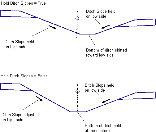

Hold Ditch Slopes
For the cases where the top-of-ditch-slope points are at unequal elevations, selects whether to hold the ditch sideslopes and let the position of the ditch shift, or to hold the ditch at the center and adjust the sideslope on the high side
Selection list
Hold ditch sideslopes, shift ditch from center

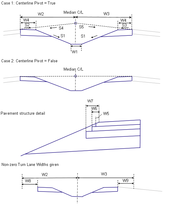

Centerline Pivot?
Select whether the profile grade and pivot point is at the centerline above the median ditch, or if it is held at the inside edges-of-traveled-ways
Selection list
Pivot about inside edge-of-travelled way

Pave1 Extension
Width that the Pave1 layer extends beyond the edge-of-shoulder. The bottom of the Pave1 layer may not extend beyond the ditch sideslope.
Numeric, positive
0.0
Pave2 Extension
Width that the Pave2 layer extends beyond the edge-of-shoulder. This should be equal to or greater than the Pave1 extension. The bottom of the Pave2 layer may not extend beyond the ditch sideslope.
Numeric, positive
0.0
Base Extension
Width that the Base layer extends beyond the edge-of-shoulder. This should be equal to or greater than the Pave2 extension. If a large value is used, the Base layer is terminated at the intersection with the ditch slope.The Base layer should not extend beyond the ditch sideslope.
Numeric, positive
0.0

Superelevation Pivot Point
The median can be configured to have the pivot point at the centerline, or at the inside edges of traveled ways. If Centerline Pivot is used, the left and right outside lane superelevation slopes are obtained from the baseline’s superelevation specifications, and the elevations of the inside edges-of-traveled-ways are calculated by applying these slopes to the left and right median widths from the attachment point. If Centerline Pivot is not used, the edges-of-traveled-ways are held to the elevation of the attachment point.
Ditch Elevations and Slopes
Superelevation or turning lanes may cause the top of the ditch slopes to be at different elevations on the left and right sides, resulting in an asymmetrical ditch. There are two options for handling this situation. If Hold Ditch Slopes is set to True, then the given ditch slopes are held constant on both sides, which shifts the bottom of ditch away from the centerline towards the lower side. If set to False, the ditch bottom is centered about the median centerline, the given slope is held on the lower side, and the slope is adjusted to match on the higher side.

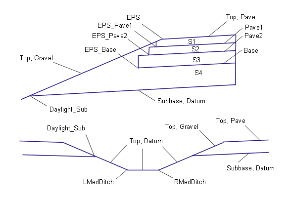

Point, Link, and Shape Codes
The following table lists the point, link, and shape codes for this subassembly that have codes assigned to them. Point, link, or shape codes for this subassembly that do not have codes assigned are not included in this table.
Point, Link, or Shape
Code
Description
Points
As shown below
Links
As shown below
S1
Pave1
S2
Pave2
S3
Base
S4
SubBase
Coding Diagram
