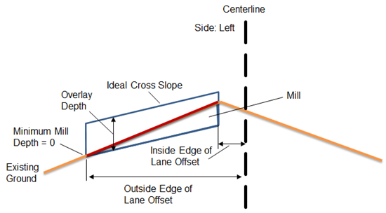

OverlayMill1Lane1Side

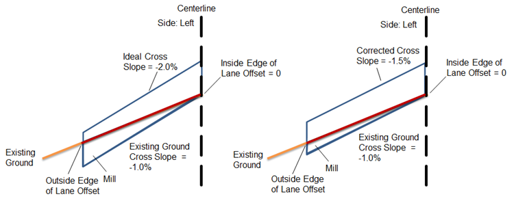

This subassembly overlays one side of an existing road, with a milling layer added as required.
The attachment point is the inside edge point of the overlay layer with finished grade cross slope.
Input Parameters

Tip: Flapping is a term used to describe how the Corrected Cross Slope for an overlay in a rehab subassembly is calculated. Flapping outcomes are different, relative to the Slope Tolerance and the Slope Difference between existing ground cross slope and ideal cross slope. If the Slope Difference is less than the Slope Tolerance for the subassembly, then the use case is considered 'within tolerance'. If the Slope Difference is greater than the Slope Tolerance for the subassembly, then the use case is considered "without tolerance."
Note: Slope Tolerance is an absolute value. Therefore, for either a Slope Difference of 0.4% or -0.4%, both have an absolute value of 0.4%. If the Slope Tolerance is 0.5%, the 0.4% absolute Slope Difference would be considered within tolerance.
  • User Defined With Flapping
    Flapping specifies how the Corrected Cross Slope will be calculated, relative to the slope tolerance for the subassembly
    • Flapping Within Tolerance:
      Corrected Cross Slope will be set equal to Ideal Cross Slope
    • Flapping Without Tolerance:
      Corrected Cross Slope will be adjusted to match Existing Ground Slope within Slope Tolerance
  • User Defined Without Flapping
    Flapping will not be used to specify how the Corrected Cross Slope will be calculated, relative to Slope Tolerance for the subassembly
    • Slope Difference Within Tolerance:
      Corrected Cross Slope will be adjusted to match Existing Ground Slope, within Slope Tolerance
    • Slope Difference Without Tolerance:
      Corrected Cross Slope will be adjusted to match the Ideal Cross Slope, within slope tolerance
  • Outside/Inside Lane Superelevation
    Outside or Inside Lane Superelevation will replace Ideal Cross Slope. Corrected Cross Slope values for the overlay layer will be defined by the superelevation table for the section instead of the Ideal Cross Slope.
    Note: If Outside/Inside Lane Superelevation is chosen but the alignment for the rehab corridor does not have a superelevation table defined, Ideal Cross Slope will be used instead.
  • Match Slope
    The Corrected Cross Slope is always set equal to Existing Ground Slope
  • Use Ideal Cross Slope
    The Corrected Cross Slope Slope is always set equal to Ideal Cross Slope
User Defined User Defined Without Flapping
Ideal Cross Slope Specifies user defined ideal cross slope. Numeric -2.00%
Lane Width The lane width, determined by the offset of the outside edge of lane from the inside edge of lane. Numeric 12.000m

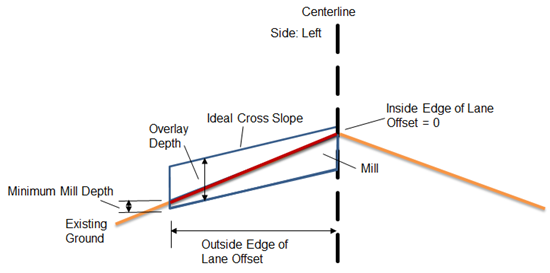

Use Profile Options Select to tie the inside edge of overlay to a profile, adjust elevation to minimum level depth, or lock to previous subassembly.
  • Minimum Level Depth
    The cross slope and elevation adjustments will meet Minimum Level and/or Minimum Mill Depth. The base is the existing surface.
  • Use Profile
    There will be no elevation adjustment. The elevation of the rehab subassembly attachment point will match the assigned profile. The cross slope adjustment will be determined by Overlay Slope Options.
  • Lock to Previous
    There will be no elevation adjustment. The elevation of the rehab subassembly attachment point will match the attachment point of the previous subassembly (in most cases this will be the previous lane's end point). The cross slope adjustment will be determined by Overlay Slope Options.
User Defined Minimum Mill Depth
Minimum Mill Depth The minimum mill depth between the existing surface and bottom of the overlay layer. Numeric 0.300m
Slope Tolerance Tolerance for varying the overlay slope. Numeric 0.50%

Behavior
This subassembly assumes that no leveling layer is added. Flapping is within tolerance to meet no level and minimum mill. You can adjust elevation if needed to meet the no level and minimum mill. Procedurally, flapping should always be applied first, followed by vertical adjustment of the overlay layer if needed.
Note: It is not supported to adjust the corrected cross slope after vertical adjustments are performed on the overlay layer.

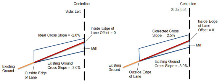

Case 1
Inputs:
Inputs
Ideal Cross Slope -2.0%
Minimum Mill Depth 0
Slope Tolerance 0.50%
Overlay Slope Options User Defined with Flapping
Use Profile Options Minimum Mill Depth
Calculations:
Input Value
Existing Ground Cross Slope -3.0%
Existing Ground Cross Slope - Ideal Cross Slope -1%
Slope Tolerance Existing Ground Slope minus Ideal Cross Slope is -1%, which is greater than the 0.5% Slope Tolerance
Corrected Cross Slope Corrected Cross Slope will be set between -1.5% and -2.5% cross slope
Adjust elevation true
Output Value
Corrected Cross Slope -2.5%

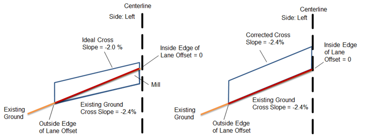

Case 2
Inputs:
Inputs
Calculations:
Input Value
Existing Ground Cross Slope -2.4%
Existing Ground Cross Slope - Ideal Cross Slope -0.4%
Slope Tolerance Existing Ground Slope minus Ideal Cross Slope is -0.4%, which is less than the 0.5% Slope Tolerance
Output Value
Corrected Cross Slope -2.4%

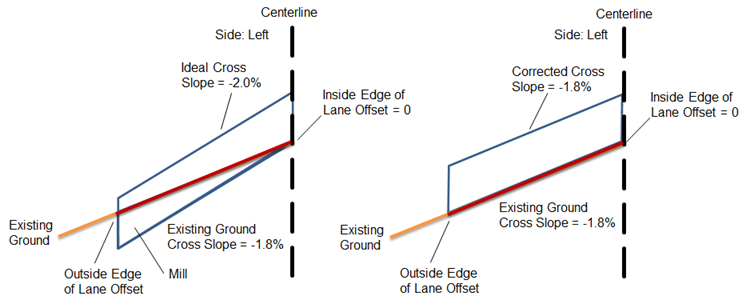

Case 3
Inputs
Calculations:
Input Value
Existing Ground Cross Slope -1.8%
Existing Ground Cross Slope - Ideal Cross Slope 0.2%
Slope Tolerance Existing Ground Slope minus Ideal Cross Slope is 0.2%, which is less than the 0.5% Slope Tolerance
Output Value
Corrected Cross Slope -1.8%

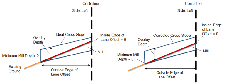

Case 4
If the existing ground (EG) cross slope is -2.0% from the IEOL to OEOL, existing ground cross slope minus ideal cross slope is 1%, tolerance is 0.5% < 1%, and adjusted cross slope is between -1.5% and -2.5%, then the adjusted cross slope will output at -1.5%.
Inputs
Calculations:
Input Value
Existing Ground Cross Slope -2.0%
Existing Ground Cross Slope - Ideal Cross Slope 1%
Slope Tolerance Existing Ground Slope minus Ideal Cross Slope is 1%, which is greater than the 0.5% Slope Tolerance
Output Value
Corrected Cross Slope -1.5%
