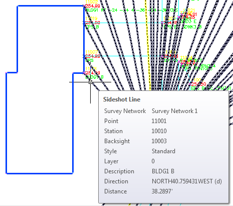

The Observations Editor vista is displayed with all the observations for the selected setup.
The observations for the setup are highlighted in the drawing.

The drawing zooms to the selected figure.
The Toolspace switches to the Survey tab with the figure selected. The survey data for the figure is displayed in the Figures Editor.
