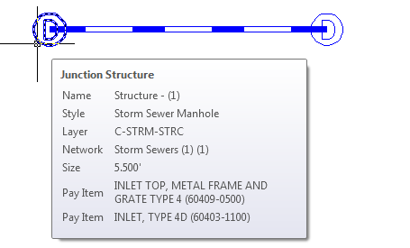

Add parts with pay items to the pipe network
panel
Find. This action creates two structures that are connected by a pipe.
The tooltip displays the description and ID of each pay item that has been assigned to that structure.

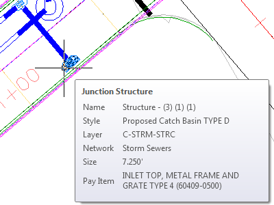

Assign pay items to existing pipe network parts
The tooltip displays the description and ID of the pay items that have been assigned to the catch basin.
Further exploration: Repeat this procedure on the other structures in the network, assigning pay item codes that are appropriate for the square catch basins, manholes, and headwalls.
