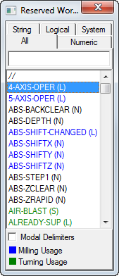

To place a reserved word inside modality brackets, select Modal Delimiters:
