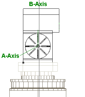

These table on table machines are supported:
- B and A stacked rotary tables - these milling machines rotate about the Y-axis, then around the X-axis. They are also called
B over A machines.
- A and B stacked rotary tables - these machines rotate about X-axis then around the Y-axis. These machines are also known as
A over B machines.

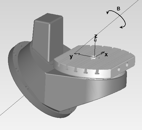

- 45 degree angled B and C stacked rotary tables -
rotate the B table about a 45 degree angled axis and then rotate about the C table.
- 45 degree angled A and C stacked rotary tables - rotate the A table about a 45 degree angled axis and then rotate about the C table.
