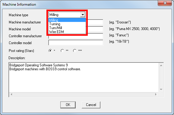

Selecting the machine type
XBUILD enables you to create CNC data files for different types of machine. Use the Machine Information dialog to determine the type of machine you want to create G-code for.
To select the type of file you want to create:
  1. Select the CNC-Info > Machine menu option. The Machine Information dialog is displayed.
  2. Select an option in the Machine type list.
  3. Click OK to save your changes and close the dialog.
    Note: Selecting a Machine type determines which options are available in the XBUILD menus.
