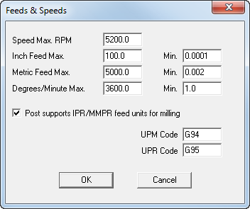

Feeds & Speeds dialog (Mill)
Defines the minimum and maximum machine speeds and feed rates. The Feeds & Speeds dialog is displayed.
You can specify the following parameters:
Speed Max. RPM — Enter the maximum speed rate in rotations per minute.
Feed Max. and Feed Min. — Enter the feed rate limits when the maximum speed rate is specified in rotations per minute.
Degrees/Minute Max and Degrees/Minute Min. — Enter the feed rate limits when the maximum speed rate is specified in degrees per minute.
Post supports IPR/MMPR feed units for milling — This shows whether the post has been configured to support IPR/MMPR. It is deselected by default. You must select this option if you have inserted the <F-UNITS> reserved word in all milling sections of the post.
UPM (Units per Minute) and UPR (Units per Revolution) describe the feed rate in terms of UPM or UPR. Only one option at a time is used by Post, depending upon FeatureCAM's segment data.
