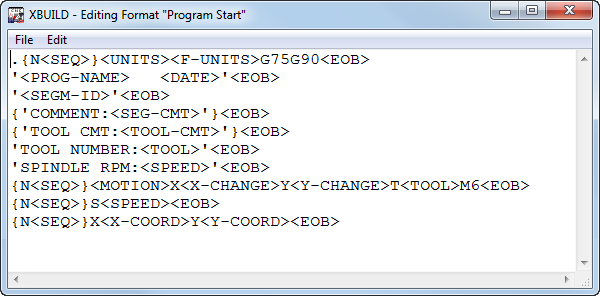

When you select an option from Formats menu, XBUILD opens the Formats editor and displays the format.
The Formats editor has two menus (File and Edit), which are used in editing the selected format; however, these menus do not change from one format to another. All formats are edited in the same way.
