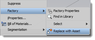

  1. Click on the object in the layout. If you want to replace multiple blocks or asset instances with the same asset, you can click on more than one object.
  2. Right-click to view the context menu.
  3. Select Factory, and then select Replace With Asset.

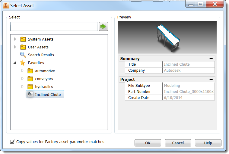

  4. Select an asset.
  5. To copy matching parameter values (not case sensitive), select the Copy values for Factory asset parameter matches checkbox.
  6. Click OK.
