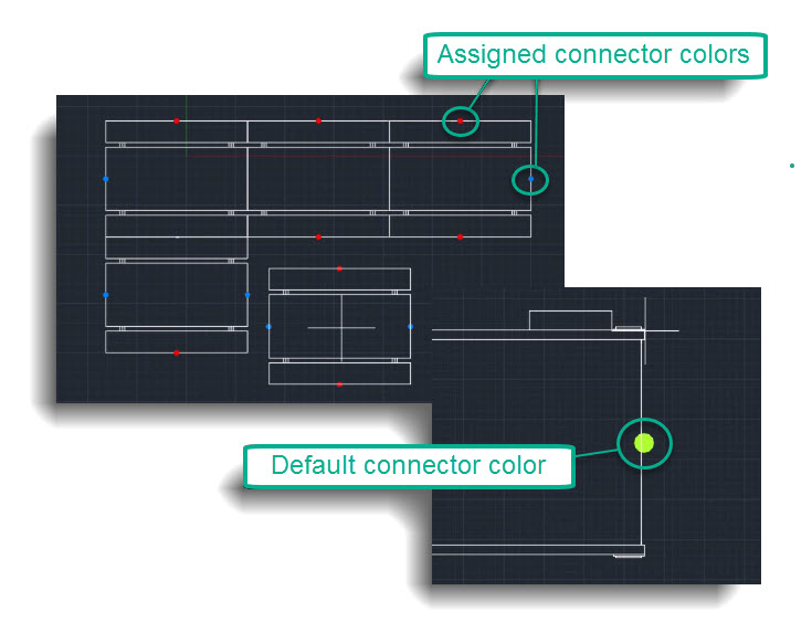

To assign a custom color to connectors
Assigning a custom color to connectors allows you to quickly identify and match connections between assets in your factory layout when placing assets.

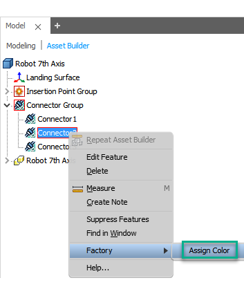

Once you have placed and defined your asset connectors, you can then assign a custom color to those connectors from the Inventor Model browser.
To assign a color:
- In the Inventor
Model browser, right click on the connector to expose a list of context menu options.
- Expand the
Factory menu options and select
Assign Color.
- Select a color from the Color palette to assign to your connector. The default connector color is green.
- Click
OK.
- Save to publish the asset to the Asset Browser.

Tip: You can also assign a custom color to multiple connectors at once by holding down the Ctrl key and selecting the connectors you would like to assign a color to. Once the connectors are selected, choose a color from the Color palette to assign that color to all selected connectors.
Customized connector colors persist throughout future sessions. In AutoCAD Factory, these custom asset connector colors display when you go to place or connect the asset in your layout.
