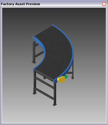

  • Preview: Launch a separate Factory Asset Preview window displaying the selected asset. You can toggle the Factory Asset Preview window on and off by clicking Factory tab Tools panel Palettes Factory Asset Preview .

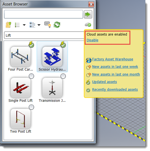

How to enable and disable cloud-based content
Cloud-based content must first be enabled before you can download cloud-based assets. Normally, cloud-based content is enabled by default and this icon appears near the top right of the Asset Browser .
This icon appears in the Asset Browser when cloud-based content is disabled . To enable cloud-based content, do the following:
  1. If you are working in a factory layout, click Factory tab Options panel Factory Options to display the Factory Options dialog box.
  2. If you are not working in a factory layout, click Factory tab Factory Launch panel Factory Options to display the Factory Options dialog box.
  3. Click the Assets tab and select the Enable Cloud-based assets check box. Uncheck the box to disable cloud-based content.
  4. Close the Factory Options dialog box.
Tip: A very quick and easy way to enable or disable cloud-based content is to click on, or hover your cursor over, the icon at the upper-right of the Asset Browser. You can then click Enable or Disable from the pop-up cloud asset information window. Observe that this window also displays information about the status of cloud-based assets and provides access to the Web-based Factory Asset Warehouse.

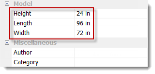

How to modify parameter values in the Factory Properties Browser
Once an asset from the Asset Browser is placed, you can select it and change the available Model parameters or Miscellaneous parameters in the Factory Properties browser. The Factory Properties browser automatically displays when a new layout is created. To toggle the Factory Properties browser on and off, click Factory tab Tools panel Factory Properties from the Palettes drop-down menu.
  1. In the factory layout, select the asset for which you want to make parameter value changes. (Press and hold the Ctrl key if you wish to select multiple assets.) Once the asset is selected, any of the values displayed in the Factory Properties browser can be edited. Only the Model parameters that were specified as Key parameters when it was published are listed in the Factory Properties browser. A select few iProperty parameters are also listed in the Factory Properties browser. These iProperty parameters include Author, Title, Company, Catalog, Keywords, and Comments.
  2. Select any of the parameter values in the right-hand column and enter a new value.
  3. You can restore a changed value by clicking the Refresh button .
  4. To finalize the change and update the asset, press the Enter key on the keyboard or click the Update button . Using the Update button enables you to update multiple parameter values at one time.
  5. To make changes to custom asset properties click .

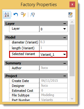

How to modify Asset Variant parameter values in the Factory Properties Browser
Parameter values of a placed asset variant can be modified using the Factory Properties browser.
  1. In the factory layout, select the asset variant you wish to modify. (Press and hold the Ctrl key if you wish to select multiple assets.) Once the asset is selected, click anywhere within the Selected Variant value field to activate the drop-down arrow at the far right.
    Note: Your asset variant parameter name will most likely be different from the example shown in the illustration.
  2. Click the down arrow to display a drop-down list of available asset variant parameters from which to choose.
  3. Select the desired parameter from the list and press Enter, or click the Update button at the top of the Factory Properties browser.
  4. The selected asset variant is updated with the new parameter value.

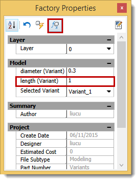

If you wish to provide a different value from any of the existing asset variant parameters, do the following:
  2. Once the asset is selected, click the Enable Variant Controlled Parameters button at the top of the Factory Properties browser to activate the Model Parameter variant name.
  3. Enter a new value for the variant parameter name and press Enter, or click the Update button at the top of the Factory Properties browser.
  4. The selected asset variant is updated with the new value and the word *None* appears in the Selected Variant field.

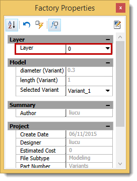

How do I move a placed asset from one layer to another?
  1. Select one or more assets from the factory floor layout. Press and hold the Ctrl or Shift keys for multiple selections.
  2. The layer name of the selected asset appears near the top of the Factory Properties browser. If multiple assets on different layers are selected, the layer name appears as *VARIES*.
  3. Click the down arrow to the right of the layer name to display a drop-down list containing the names of all layers defined in the current layout.
  4. Select the layer you wish to move the selected asset(s) to.
  5. The drop-down list closes and the layer you selected replaces the previous layer name.
  6. Click the Update button in the Factory Properties browser toolbar to move the asset(s) to the different layer.
