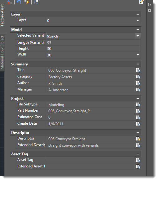

Values for many of the parameters listed in the Factory Properties browser can be selected and edited to change the properties of an asset. Assets can also be moved from one layer to another. Any changes made to a selected asset only reflect in that specific instance. Changes do not affect the Factory Assets library.
To access the browser, select the
Factory tab
Tools Panel
Palettes
Factory Properties
Factory Asset tab. You can also access the browser by right-clicking on the asset and selecting
Factory
Factory Properties from the context menu.
The Factory Properties browser becomes populated with asset data when a parameterized asset is selected in a factory layout assembly.
If a property value is derived from a key parameter expression included in the asset properties definition, you can hover your mouse over the value to view the expression. For example, "The height is 70in" might appear in the asset description; hovering over the field shows that the expression used to define the description is "=The height is <height>".

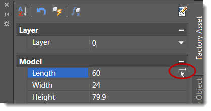

When updating a distance measurement (for example, height, width, or length), you can either type the value in the field or click the Measure icon to define the distance by selecting two points.
Information is organized in the following categories. If a field is grayed out, the value cannot change. If an asset is not defined for a category, the category does not display. Custom categories that were created in Inventor also display here.
Update. To override defined variants with a new value, click
Enable Variant Controlled Parameters to activate the variant field for editing. You can update multiple assets at the same time by selecting them and then updating the measurements in the browser. If the selected assets have different values for a specific parameter at the time you select them, *VARIES* appears in the parameter field. To set the parameter to the same measurement for all the selected assets, replace the word VARIES with the new value and click Update.
in the upper right corner of the browser..
